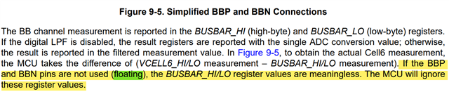

How do I configure these 2 pins (BBN&BBP) if not used? Seems could be left floating in datasheet 9.3.2.1.1.4. Is there any clearer recommendation for either left floating or connected to GND?

Hello Joyce,
As the image you shared shows, leave these pins floating when unused.
