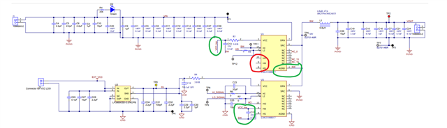

LMG3100EVM-089 design
it use low side bootstrap directly as the power supply of upper one to driver the upper gan
upper chip HB HS HO floating

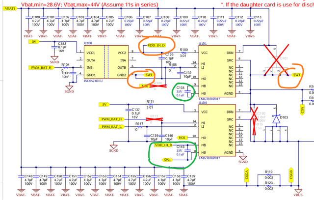

Schematic — PMP23421 design
I have following questions compared these two designs:
1、I notice digital isolated power was used in this design I wonder why not design like LMG3100EVM-089 design and add one extra digital isolator
2、upper chip one bootsrap is added i also wonder why?

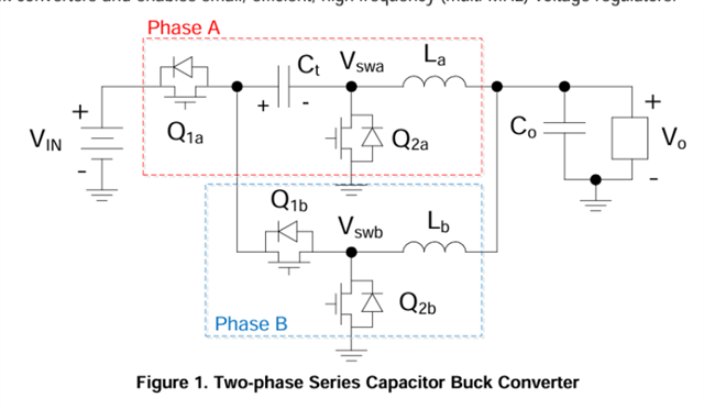

3、if I want to use series  cap buck converter  could you please provide the  best driver reference design for this topology? smaller size will be prefer.
  • and how to design uperside HI pin one is connected to SW one is floating
    Bellow are answers to your questions:
    1. LMG3100 can be configured to input both LI/HI signals through low-side device. The low-side device will internally level-shift the HI signal and output it for the high-side device. Diagram:
    This configuration will result in large propagation delay for the HI signal, which is troublesome for high frequency designs. The reference designed you shared uses a digital isolator for the high-side input signal to avoid this propagation delay.
    2. This capacitor on high-side FET is not necessary, and does not need to be included in this schematic. It is a mistake. There are no problems that will arise but it is unnecessary as shown in the datasheet

    4. You ask "and how to design uperside HI pin one is connected to SW one is floating" . Can you elaborate on this question more please?
