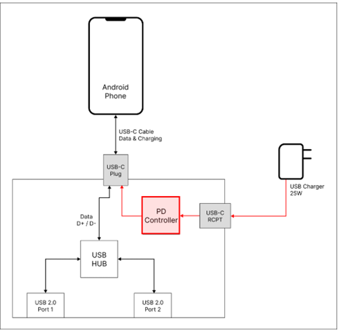

Customer is looking for USB PD controller IC.
- Application : Fingerprint recognition device
Q1) Can the TI TPS25750 be applied to the ‘PD Controller’ in the gram below?
Q2) If there is another more suitable part, can you recommend it?
Please check. Thank you.
    The TPS25751 is recommended over the TPS25750.
    The TPS25750/1 are single port devices.  You would need a dual port device as well as some logic to perform the PD pass through. Similarly you could use two TPS25751s and a microcontroller to do the same.
    No.  Not at this time.
