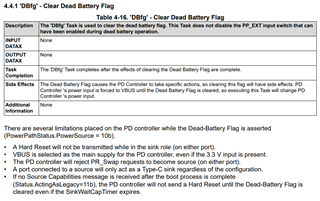

  • Hi Ryu,
    After making it receive power from the tablet with J2 unconnected, it does not shift to the operation of receiving power from J2 even if power is connected to J2.
    If TPS25751 is first powered from J2 (VBUS), the device will boot up with the dead battery flag raised. When dead battery flag is raised, TPS25751 is unable to become the source until the DB flag is cleared. The DB flag can be cleared with two methods:
    1. EC sending 4CC command "DBfg" which instructs TPS25751 to clear its dead battery flag
    2. Configuring one of TPS25751 GPIO pins to be input event "Barrel_Jack_Event" and toggle the pin high.
     If you're not intending to test dead battery flag, I recommend first powering the EVM through J3 port first and then connecting J2 port to the tablet.
    Let me know if there's any questions or concerns!
