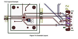

TUSB542: Clarification on Datasheet Layout Guidelines
Part Number: TUSB542

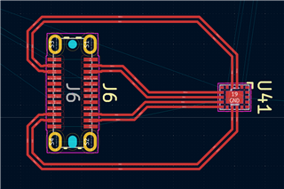

I have a misunderstanding regarding your suggestion to "route all differential pairs on the same layer." In the example layout, I noticed that half of the SS lines are routed on a different layer, even though it is possible to keep them on the top layer by swapping the polarity. Is there a specific reason for this design choice?
I would appreciate your clarification.
