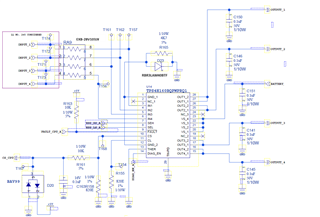

  • Hello Alan,
    Thanks for reply.  I will check VF at GND pin at -20'C.
    Diode used is of ROHM make, PN - RBR3LAM40BTF. Its VF is less than 0.4V for 100mA at -25C
    Please find below snip of schematic.
    Sharad
  • Sharad,
    Looking at the schematic, one issue that sticks out here is that the CL pin is connected to the system ground, not IC ground like it is supposed to. The current limit circuitry of the high-side switch is with reference to the device's ground so the resistor should be connected before the IC resistor/diode network. What is likely happening is that at lower temperatures the resistance is increasing to a point where the current limit looks like it is being hit so the device shuts off.
    To test this out- you can short the diode/resistor network and make IC_GND the same as GND (before making any layout changes).
    Tim
  • Thanks and  for quick replies.
    Shorted GND_1 (Pin 1) , GND_2 (Pin 12), & CL (Pin 11) and tested, solved my issue.
    Corrected schematic & Layout as per EVK.
