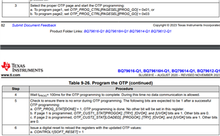

BQ79616-Q1: Unable to unlock OTP Programming
Part Number: BQ79616-Q1
Other Parts Discussed in Thread: MSPM0L1304, BQ79616,
Tool/software: CCS Theia (IDE), MSPM0L1304 (host MCU)
Here is my code (with some irrelevant portions deleted). On lines 187 and 247, it is detected that the OTP programming is locked. I checked to make sure that I was following the correct procedures in the BQ79616 datasheet, but I can't see anything I'm doing wrong. Please help!

bool program_bq79616_otp(void) {
    if (program_bq79616_otp_page2() || program_bq79616_otp_page1()) {
        return true;
    } else { // neither OTP programming was successful - try one more time
            return true;
        } else { // error - neither OTP programming was successful
            return false;
bool program_bq79616_otp_page1(void) {
    uint8_t data[4];
    data[0] = 0b000;
    command_bq79616(SINGLE_DEVICE_READ, BQ79616_DEVICE_ADDR, OTP_CUST1_STAT_ADDR, data, 1);
    if (response_bq79616() == 0) {
        return false;
    if ((bq79616_response_data[0] & 1) == 0) { // page 1 not yet programmed
        // Unlock the OTP programming
        data[0] = 0x02;
        data[1] = 0xB7;
        data[2] = 0x78;
        data[3] = 0xBC;
        command_bq79616(SINGLE_DEVICE_WRITE, BQ79616_DEVICE_ADDR, OTP_PROG_UNLOCK1A_ADDR, data, 4);
        // Check to confirm the OTP unlock procedure is successful
        data[0] = 0b000;
        command_bq79616(SINGLE_DEVICE_READ, BQ79616_DEVICE_ADDR, OTP_PROG_STAT_ADDR, data, 1);
            return false;
        if ((bq79616_response_data[0] >> 7) != 1) { // error - OTP programming locked
            return false;
        // Select the proper OTP page and start the OTP programming
        data[0] = 0x01;
        command_bq79616(SINGLE_DEVICE_WRITE, BQ79616_DEVICE_ADDR, OTP_PROG_CTRL_ADDR, data, 1);
        // Do the OTP programming
        set_bq79616_otp_settings();
        // Wait 100 ms for the OTP programming to complete.
        delay_us(100000);
        // Check to ensure there is no error during OTP programming.
        data[0] = 0b000;
            return false;
        if ((bq79616_response_data[0] & 1) != 1) { // error - unsuccessful OTP programming
            return false;
            return false;
        if (bq79616_response_data[0] != 0b00001111) { // error - unsuccessful OTP programming
            return false;
        // Issue a digital reset to reload the registers with the updated OTP values
        data[0] = 0b10;
        command_bq79616(SINGLE_DEVICE_WRITE, BQ79616_DEVICE_ADDR, CONTROL1_ADDR, data, 1);
    return true;
bool program_bq79616_otp_page2(void) {
    uint8_t data[4];
    data[0] = 0b000;
    command_bq79616(SINGLE_DEVICE_READ, BQ79616_DEVICE_ADDR, OTP_CUST2_STAT_ADDR, data, 1);
        return false;
    if ((bq79616_response_data[0] & 1) == 0) { // page 2 not yet programmed
        data[0] = 0x7E;
        data[1] = 0x12;
        data[2] = 0x08;
        data[3] = 0x6F;
        command_bq79616(SINGLE_DEVICE_WRITE, BQ79616_DEVICE_ADDR, OTP_PROG_UNLOCK2A_ADDR, data, 4);
        data[0] = 0b000;
            return false;
            return false;
        data[0] = 0x03;
        delay_us(100000);
        data[0] = 0b000;
            return false;
            return false;
            return false;
        if (bq79616_response_data[0] != 0b10001111) { // error - unsuccessful OTP programming
            return false;
        data[0] = 0b10;
    return true;

  • I am trying to follow the instructions on pages 82 and 83 of the BQ79616 datasheet to program the OTP. For each of page 1 and page 2 of the OTP, I write data to the OTP_PROG_UNLOCK registers to unlock the OTP, and then I read OTP_PROG_STAT[UNLOCK] to see if the OTP was unlocked. For both page 1 and page 2, I detect that OTP_PROG_STAT[UNLOCK] = 0, indicating that they are both locked and that I'm not able to continue with the rest of the OTP programming procedure.
    I can give more details about the rest of the code if you think it will help.
  • Yun,
    Where are you writing all 8 of these commands?
    Be sure you are writing them in the correct order with no other writes in between.
    If it does not work get a logic analyzer and lets look at the data going across.
    "Each block of registers must be written in order (that is, A, B, C, then D) with no other writes or reads between. The best practice is to use the same Write command to update. Any attempt to update the registers out of sequence, or if another register is written or read between writes, the entire sequence must be redone."
          Quentin
  • Hi Quentin,
    In one function, I use a single Write command to write to the OTP_PROG_UNLOCK2A to OTP_PROG_UNLOCK2D registers, then read OTP_PROG_STAT[UNLOCK].
    In a separate function, I use a single Write command to write to the OTP_PROG_UNLOCK1A to OTP_PROG_UNLOCK1D registers, then read OTP_PROG_STAT[UNLOCK].
    Yun
  • Yun,
    Show me these commands and their order please.
         Quentin
  • Hi Quentin,
    This is the order it's done in:
    1. Use a single Write command to write to the OTP_PROG_UNLOCK2A to OTP_PROG_UNLOCK2D registers.
    2. Use a Read command to read OTP_PROG_STAT[UNLOCK] -- this is where I detect that OTP is locked, so I exit before I can finish the rest of the OTP programming for page 2.
    3. Use a single Write command to write to the OTP_PROG_UNLOCK1A to OTP_PROG_UNLOCK1D registers.
    4. Use a Read command to read OTP_PROG_STAT[UNLOCK] -- this is where I detect that OTP is locked, so I exit before I can finish the rest of the OTP programming for page 1.
    Yun
  • Yun,
    Write to OTP_PROG_UNLOCK1A-D in one write first.
    Then write to OTP_PROG_UNLOCK2A-D in another write.
    Only then can you read the status register.
         Quentin
