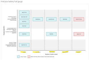

    Yes the BQ27Z746 chip would be a good choose to determine the charge life of a Li-ion cell for only a single cell application, typically seen with phones, tablets, watches and etc. The chip is able to talk to the MCU with i2c function. I would strongly recommend doing a proof of concept with the evaluation board BQ27Z746EVM-047 and the MCU EVM aswell and following the "Techinical document>>User guide>> BQ27Z746 Impedance Track Battery Gas Gauge and Protection Solution for 1-Series" documentation to start testing the system.
    However if you are planning using more cells in series than refer to the chart below.
