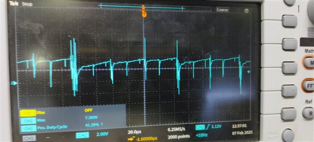

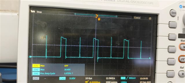

NOW  I AM FACING AN ISSUE OF NARROW DUTY PULSE AND A 40% DUTY PULSE.
HERE I DONT KNOW WHY ITS LIKE THAT DUE TO SOME REASON I AM OBSERVING THIS OSCILLATION. CAN YOU IDENTI FY THE ISSUE AND HELP ME RESOLVE THIS. I WILL BE SHARING THE WAVEFORMS AND THE VALUES AS PER THE APPLICATION CIRCUIT PROVIDED IN THE DATASHEET.

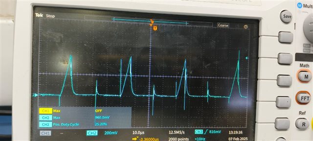

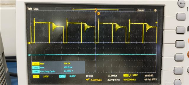

and till 3A its working fine but as soon as i apply 3.7 a load or beyond its oscillating. and i observe the audible noise as i increase the load.
i will share the corresponding comp Cs and Vds and GATE WAVEFORMS IN  THE ATTACHMENTS.

    It looks the operation shows typical subharmonic behavior - pulse wider narrow wider, alternating. Usually a current slope compensation is required to help resolve this.
