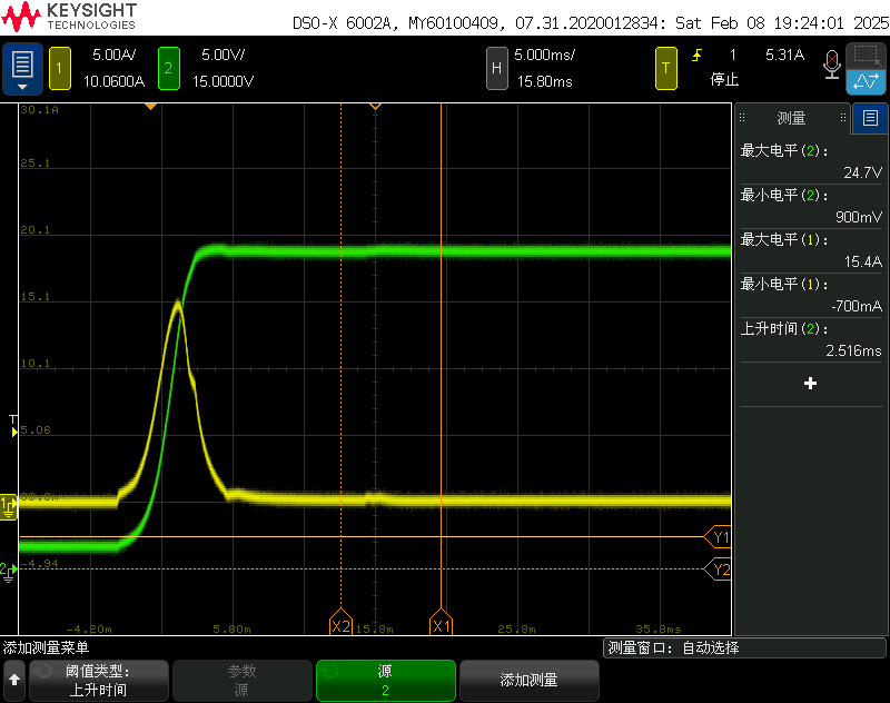

Hi there,
When connecting a large capacitive load, approximately 2mF, the TPS259830 fails to turn on properly. During this time, the measured inrush current is much lower than the set current limit of 14A. Despite adjustments to configurations such as retry attempts, retry intervals, and output voltage slew rate, the device still fails to start up. Could you provide any recommendations for troubleshooting and resolving this issue?
