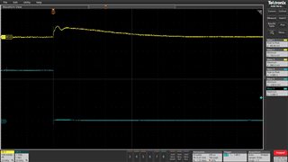

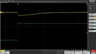

  • Hi Jeff,
    Please find below the transient test result.
    For the given application setting, the highest achievable slew rate was ~36A/us. Channel 2 (in BLUE) represents the output current, where 1V corresponds to 10A.

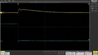

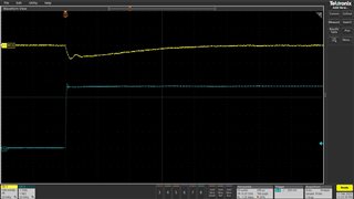

  • Hi Jeff,
    Here is a retake of the waveform, now showing the peak-to-peak, minimum, and maximum values.

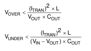

    3. If the input voltage is changed from 12V to 5V or 3.3V, with Vo=0.75V, will changing the input voltage improve the transient response capability?
    According to the buck converter output voltage formula Vo=Vin*D: a. Vin=12V, Vo=0.75V, Duty=0.0625 b. Vin=3.3V, Vo=0.75V, Duty=0.22727
    Theoretically, a lower input voltage results in a greater duty cycle, which means the ON-time of the switch is longer. When there is a sudden large load change, a greater duty cycle would allow more energy to be supplied, potentially improving transient response. Is this understanding correct?
    The energy levels will be higher with a higher input voltage (Vin) because this causes more inductor ripple, which may help reduce undershoot a bit. The datasheet has an equation for estimating overshoot and undershoot in the applications section.
