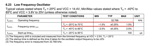

  • Hello,Jose
    Now we have a sleep setting for 1S wakeup to be used as a sleep timing, this timing is very accurate at room temperature, but at -20℃, the timing error can be -14% to -15%. So we're guessing that's maybe the reason. What do you think

  • Hello,Jose
    I found the 32.768kHZ Oscillator perameters in the user manual, the 7.8125 ms step size has a -1.5% to +1.5% error at -20℃.It seems that the error in our test data is much large than in the user manual.
    Is the error of 32.768kHZ Oscillator we found correct?  Why is the difference so large?
    zehu
    Your observed 14–15% timing error corresponds to a 16.27–17.64% frequency error in the 32.768 kHz oscillator, which is consistent with your test data.
    The datasheet specifies a −1.5% to +1.5% frequency error at −20C, but your observed error (16.27–17.64%) is much larger. Possible reasons include environmental factors (e.g., voltage, humidity) or test setup issues.
