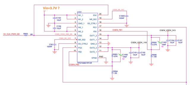

TPS7A88: Vin supply is about 3.7V for the LDO TPS7A88 with 3.3V and 1.8V Vout
Part Number: TPS7A88
Hi TI Expert,

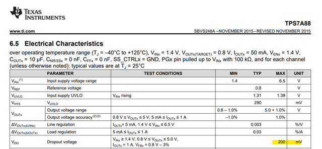

Please refer to below SCH for TPS7A88, our customer would like to use 3.7V(3.68V or 3.76V) for the LDO's input, and the LDO have two outputs with 3.3V & 1.8V, looks the datasheet of TPS7A88 as below shows the LDO has only max 200mV dropout at max output current, which means the theoretical min input voltage requirement is 3.5V(3.3V+200mV), the 1.8V is no concern for the dropout, so the LDO should be still able to work properly with the input voltage of 3.7V(3.68V or 3.76V) , correct?
Would you please help to double check? Look forward to your feedback soon, thank you.
TPS7A88 : dropout voltage=200mV max
