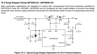

Can LM74502H-Q1 tolerate 70V max rating? Customer wants to use it in 48V system. Thanks.

Hi Grey,
LM74502H-Q1 can be used for 70V rails using the surge stopper configuration.

Hi Shiven,
Thanks for reply. For 70V/40ms transient voltage, is the surge stopper configuration still needed?
