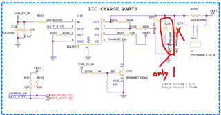

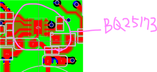

My customer designed a supercap charging circuit with BQ25173 as shown below and is testing its operation.
Supercap specifications
- Capacity: 390F
- Charging voltage: 3.6V
- Charging current: 750mA
They confirmed that the 5V input to SB_5V_IN is normal, but the supercap voltage is 2.2V and the charging current does not flow.
Q1. Please review if there is a problem with the circuit design.
Q2. Please advise on what is causing this issue
