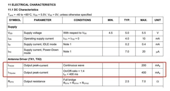

Hi Team,
For TPS7B8250QKVURQ1, can we share the time duration for the current limit (ICL) threshold?
Like other LDOs, there is a ton time for 400ms.
Thank you

Hi Frank,
The current limit is implemented as a separate loop to turn off the pass-FET switch. Normally the current limit may take hundreds of micro-seconds to be fully engaged.
As for the current limit threshold delay time, we normally expect 100us - 1ms for the current limit loop to be fully engaged.
