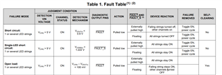

2. My customer wants to turn off all the outputs if one of the channel have fault conditions like short or open. Is it posibble to make it?

    1. For our device, PWM is an input signal, the channel ON is controlled by PWM signal.
    2. Yes, our device can support one-fail-all-fails function. Please see below fault table.

    2. Confirmed.
