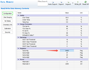

BQ27427: Why does the battery level stop at 99% during charging?
Part Number: BQ27427
Other Parts Discussed in Thread: EV2400

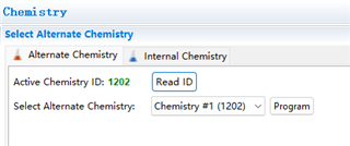

As I asked, I directly connected my PCB with EV2400. There is only one I2C device, BQ27427, on this PCB. BQ studio software can read the relevant information normally, as shown in the picture. The battery information has been set, but it keeps stopping at 99% during charging. The FC flag cannot be set and self-learning cannot be completed. May I ask where this is not configured? At the end of the document, I have attached the exported GG file.
Here is the configuration file:
5460.myConfig.gg.csv
