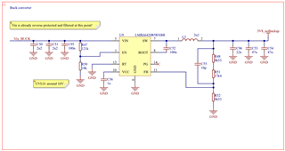

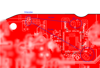

We've got a problem with the TPS61094 in combination with a supercap and a capacitive load.
The TPS61094 is fed by a DC/DC buck converter (LMR66420) at 3.83 Vin.
The output voltage is selected as 3.6 V.

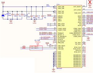

On the output of the TPS61094 are various things: an LDO linear regulator for an additional voltage rail (which in turn has an MCU and other peripherals) and a modem.

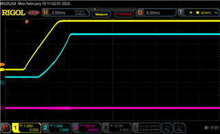

Upon powering up the board, the supercap does not charge and it seems as if the TPS61094 is just in force bypass mode:

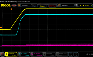

Yellow: VIN, Blue: VOUT, Purple: VCAP
However, when I remove the two large capacitors (alu/poly 180uF each) from the modem, the supercap starts charging upon powerup (can also confirm by looking at the current drawn from the bench PSU):
