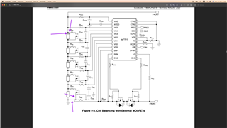

Hello
For the cell balancing at the Batt+ Batt- like you see in the image:
Can I use the MAIN Batt+ and Batt- wire for the cell balancing wire too? Or do I need to separate those two wires, because of disturbance?
Ive planned to use the MAIN Batt+ and Batt- wire for the cell balancing is that okay?
Silvan
  • Hello Silvan,
    I would recommend to separate it at least on the PCB. The high-current path of the battery current should be separate from the IC's currents. A net-tie between BAT- and Vss/ground is often added to make that distinction clear.
    However, there should not be much disturbance, because balancing is stopped during voltage measurements.
