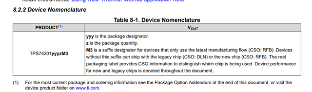

TPS74201: Does the TPS74201 with M3 means new chip?
Part Number: TPS74201
In the datasheet, it said there is new chip and legacy chip and seems use the M3 to separated it.
So does it means that TPS74201RGWRM3 is new chip, we can use the new chip spec to evaluate, but the TPS74201RGWR would contain both new chip and legacy chip, we need use the legacy spec to evaluate.
Right?
