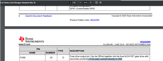

Hi expert,
How to connect CHG pin if not used? Can we leave floating if not used? Thanks.
BR,
Ryker
Hello Ryker,
If the FUSE pin is not used than you would connect it to VSS.
Alan
Hello Ryker,
It is not recommend to not use the CHG pin but you could leave the CHG pin floating.
Thank you,
Alan

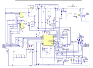

Hi Alan,
Could you help to provide the typical external balance circuit of BQ40Z80? Thanks.
BR,
Ryker
Yes, please into the EVM and datasheet to see the typical schematics and layout for the BQ40Z80. You should be able to take heavy Influence from them.

Hi Alan,
But I can't find the balance circuit in above documents? Could you help to point out how to design the external balance circuit?

Hello Ryker,
Sorry for the confusion but if you are designing a external balance circuit using a TI gauge BQ40Z80 I would rely on the image below, seen located in the previously mention post. As a designer of the PCB your team would have to modify some aspect of this schematic such as connector for load/battery, select LED to be on the board, determine if the FETs are right for your application and etc. If this project is still in early development of the hardware stage I would recommend using the EVM to do a proof of concept of the system.
