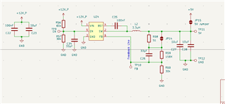

I designed some buck converters for my pcb, trying to follow the design guidelines specified in the datasheet and the values suggested. When testing the response to a transient consumption and ripple current I get pretty high values. What could cause this issue? Is it mainly a layout issue or more related to component selection?

    Could you pls kindly share me the schematic? And what's the working condition?

  • Yes of course! I followed the component values recommended in the datasheet. When routing, I tried to follow the basic sketch provided in the datasheet and the design guidelines. Voltage wise it was accurate, but the transient response and noise is horrible. Thanks in advance for the help!

  • Sorry for the misunderstanding. The operating conditions are:
    Vin: 12V
    Vout: 5V
    Iout: 0.5A Nominal / 1.2A Peak

  • Hi Ivan,
    The schematic is good. For the layout, pls kindly find below comments:
    Keep VIN and GND traces as wide as possible to reduce trace impedance. The wide areas are also an advantage from the view point of heat dissipation.
    Place the input capacitor and output capacitor as close to the device as possible to minimize trace impedance.
    Make the trace of the FB node as small as possible to avoid noise coupling.
    You can find an example of the layout in datasheet 8.4.1.

  • Figure 8-16 from section 8.4.2 is pretty vague in terms of example layouts. I tried following figure 8-16 as shown in the attached picture from the previous reply. I was wondering if a cheap Output capacitor might be to blame for the bad step response? That is my only concern, as output ripple is tolerable, although high. Can it also be the inductor to blame?

  • Yes, the device shorts VIN to GND. Can the regulator do that because of an unstable output response or is it exclusively a input condition that the regulator can fail in such a way?
  • Hi Ivan,
    In general, it will not be related with the unstable output, but I would recommend you can check below ways if there is VIN to GND short.
    Vin Cap too far away causing SW spike too high or too negative to cause LSF or HSF damage
    Input voltage surge/ESD
    Input power supply bad performance
    Inductor saturation current too small
    Peripheral components missing/quality issue (Vin Cap, Boot Cap, FB resistor, etc.) causing internal logic mal-function
    IC pin to pin short causing EOS
    Soldering quality issue causes components open/short or IC pin open or pin to pin short
    Thank you!

  • Thanks. I think it is a bad input power supply that has a negative transient. Even though I have a reverse blocking diode in series. I think it is not fast enough.
    Regarding output instability mentioned earlier. Can a cheap capacitor with high ESR or highly derated at high frequencies be the cause of the instability? I am leaning to that being the cause, but i am not certain that it could cause those kinds of output responses.
  • Dear Ivan,
    I would recommend you can follow the datasheet LC table. In general, when we design our devices, we simulate a couple of LC combinations and also validate a couple of those combinations in our labs and those combinations are then recommended in the datasheet. In general, when we design our devices, we simulate a couple of LC combinations and also validate a couple of those combinations in our labs and those combinations are then recommended in the datasheet.

  •   Thanks for the reply. As previously stated, I tried following everything the datasheet said. Component Values, inductor ratings, layout guidelines and recommendations, etc. I have a small lab and cannot measure very much, that is why I asked for help here. Simplifying stability checks is not really helpfull, as i know my system is unstable. Stability Analysis and Design of D-CAP2 and D-CAP3 is a very generic document outlying the general transfer function of converters with D-CAP control mode, it does not help very much as it does not provide values for most of the transfer function.
