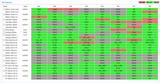

BQ76940: Under temperature during charge (UTC) not tripping
Part Number: BQ76940
Other Parts Discussed in Thread: BQ78350
I have a BQ76940/BQ38350 chipset. UTC is set in Enabled Protections B. A valid under temperature value is set.
When the battery gets below the threshold during charging, the UTC safety status flag on the register screen activates (turns red).
Both DSG and CHG Operation Status A flags remain on and the pack continues to charge.
Is there another setting I am missing to enable this feature?
