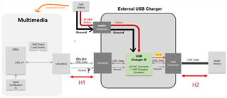

I want to create a USB charger module that can connect to the car's multimedia system and support CarPlay, but there are a few points I'm not sure about. Can you help me? I plan for the connections to be similar to the diagram below.
Q1-) What is your opinion on my connection schematic?
Q2-) I will connect the IC's power supply to the car's battery (9-16V, GND), and I plan to connect only the D+, D-, and GND pins to the multimedia system (H1 Harness). Are these pins suitable? Will not matching the Vcc-Vbus (5V) voltage between the multimedia system and the USB charger module cause a problem?
Q3-) Is it correct to take the Ground from the H1 cable harness? Because if the current flows through this cable instead of the main connector, I don't think this cable can handle it.
best regards
  • Hi Ömer,
    Your block diagram generally looks correct.  You may want to consider a USB D+/D- redriver based on the distance from the CPU host to the consumer facing port.  I also don't see CC1/2 labeled from 832A-Q1 to the USB connector.  Will this be a Type-C or Type-A port?  Finally, you can delete the USB Power Load Switch since TPS25832A-Q1 will control VBUS.
    That is all acceptable.
    Include GND in H1 to ensure USB signal integrity.  It won't carry any significant current.  The GND current still goes through "main connector".
