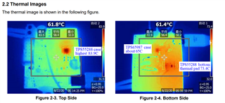

    2. "Also, thermal performance should be considered. You may need to reduce the switching frequency for better thermal performance.”
      1. Would it be possible to find out, whether thermal test were performed with eval boards or reference designs at +25°C only?
      2.  Could you please find out, which operating conditions (Vin, Vout, Iout, Tamb) were applied, as thermal images (Figure 2-3, and Figure 2-4) form the  document Test Report: PMP40801 were taken?

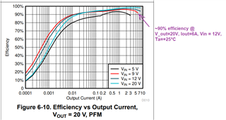

      3.  Could you also please find out, which board was used for efficiency vs output current measeurements, Figure 6-10 from datasheet?
        According to that  graph the last point for the efficiency @ 20V_out, 12V_vin, Ta=25°C was at 6A, right?

    • Would it be possible to find out, whether thermal test were performed with eval boards or reference designs at +25°C only?
    •  Could you please find out, which operating conditions (Vin, Vout, Iout, Tamb) were applied, as thermal images (Figure 2-3, and Figure 2-4) form the  document Test Report: PMP40801 were taken?
    I don't have this information. I can provide EVM thermal performance. Do you have NDA with TI?
    Efficiency is test in EVM board.
    the 6A curve is 9V Vin. For 12V Vin, maximum output current is 8A.

  • Hi Josko,
    I have received NDA confirmation. I sent you the EVM thermal performance. Please send me the working condition as I asked above.
    Mulin
