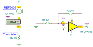

I am using REF200 as constant current source for thermistor interface.
I am able to get better results from 10Kohm. to 680ohm.
But the need is from 43kohm to 680ohm.
How to keep constant current at higher resistance value as well?
Below is circuit diagram:

  • Hi Andrew,
    Thank you for quick response.
    Below are readings I took at different resistance and current is not constant.

  • Hi PK,
    Thanks for the extra information!
    It seems that your compliance voltage might be too low. Please try to increase the value of V+ to see if this helps resolve the issue.
    To maintain a current of 100uA at a resistance of about 42KOhm, the required voltage would be about 4.2V.
