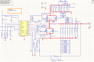

For an input voltage of 28V to 60V, the output specs required are 12V, 8A output.
I calculated the compensation network based on the inductor (whose calculation was done based on buck converter inductor calculation) and output capacitance (kept same as that given in the datasheet) mentioned in the schematic below. The type three compensator given in LM5146 used pole placement method for controller calculation. I took L value as 33uH and output capacitance as 110.1uF.
In the datasheet they mentioned poles and zeros placement assumptions, I took those assumptions and calculated compensator network values. Could someone verify the same? I took Cout same as what was given in EVM of LM5146 Q1 for keeping the Resr of output capacitance same so that ωesr doesn't change, which in-turn makes sure ωp2 remains same. Can someone verify the compensator network calculations?
For ILIM calculation I kept both options of Rds(on) sensing and shunt resistor sensing, but in the board, I have populated the shunt resistor sensing option (R16, R17, C20) and (DNP: C3 and R6)
The output voltage however, is coming out to be 3.6V instead of 12V. Could someone let me know what changes can be made to the compensator network and if the power section calculations are correct. The switching frequency of the converter is 400KHz.

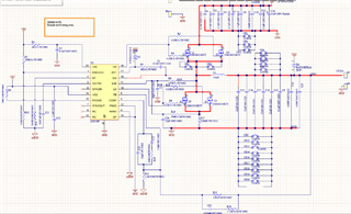

  • Hi, thanks for replying. I used the calculator however the inductor calculations were not matching when I used regular buck converters' inductor value calculation. Also, certain values like output capacitors ESR was not mentioned in the datasheet of the capacitor so I had to back- calculate RESR based on the capacitor used in the EVM LM5146-Q1.
    Here is another picture of the schematic.
  • Hi Anushka,
    I would like to know your design parameters. Just populate the Cap and Resistor values that you have chosen in your schematic in the quick start calculator. I also need to know the derating of the capacitors. This is where I see an obvious problem - the rating of output capacitors is 16V - there will be significant DC bias derating of the capacitor. It is recommended to use capacitors of atleast 25V rating for your use case.

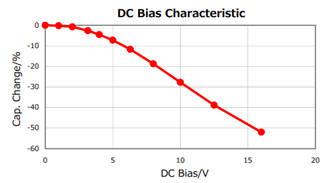

    For CGA6P1X7R1C226M250AC - if you look at the characterization sheet on the vendor's website:
    At 12V - the capacitance derates by ~40% - this is important to take into consideration when calculating the value of the effective output capacitance.
    Therefore, a 22uF cap will effectively be ~13uF.
    For the GCM32EC71E226KE36L derating is -23% (this data is also available on the cap vendor's website) - therefore, a 22uF cap will effectively be ~17uF.
    Hope this gives you an idea on how to select output capacitors.

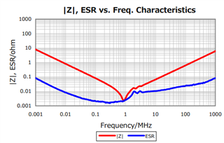

    Similarly, there are also graphs available for the ESR of the capacitor. For CGA6P1X7R1C226M250AC it looks like:
    You can find the ESR at the switching frequency that you have chose, In your case, at 400kHz - ESR ~1mOhm.

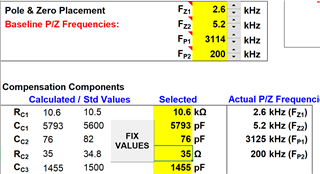

    Coming to the compensation values - the quick start calculator simplifies your work and calculates values based on your inputs. The values calculated by the Quick start calculator are exactly the same that you will get from the datasheet formulae:
    Regarding the mismatch:
    Fz1, Fz2,Fp1 and Fp2 are values that you can choose. Based on the values you select - the calculator suggests the values for Rc1, Cc1, Cc2, Rc2 and Cc3. The Actual P/Z frequencies are calculated based on the values you have populated in the selected column.
    As an example - I am choosing the same Fz1, Fz2,Fp1 and Fp2 as in your sheet and choosing the same Rc1, Cc1, Cc2, Rc2 and Cc3 that the tool suggests:
    You will see that the actual values are more or less the same but this will change when the selected values changes (as you have done in your case).
    The Bode Plot that you see is plotted using the selected value column - you can play around with these values to reach a frequency response that is acceptable. The Baseline P/Z frequency section in the quick start calculator helps suggest some initial starting values for the compensation design.
