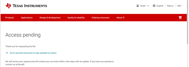

May i know how to get customization tool for TPS65994AD?
I found a link on E2E forum and apply it but it's pending(refer to below photo) and I didn't get email from system. Could you help us to check the problem?
