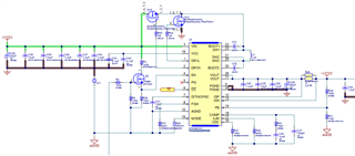

I am experiencing an issue while using the TPS552882RPMR. The VSYS is powered with 24V from a 10A bench power supply, and the output is configured for 12V/5A. However, the output current is limiting at 3.8A. Below is the detailed circuit design:

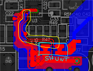

Additionally, here is the PCB layout showing the routing of the shunt resistor:

    Thank you for reaching out. Can you change R49 to 36.6k and do the test again?
    Mulin
    I tested with a 20kΩ resistor on R49, and the current still limits at 3.8A.

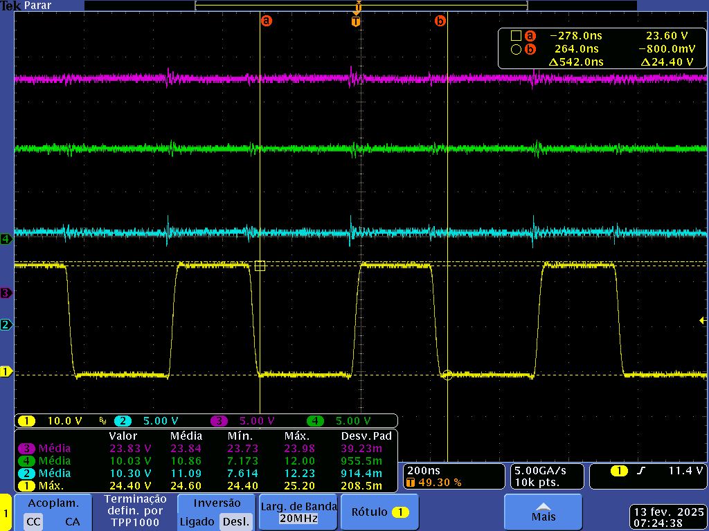

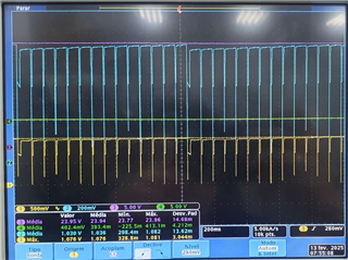

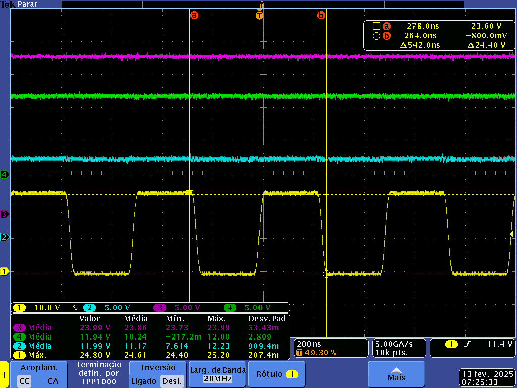

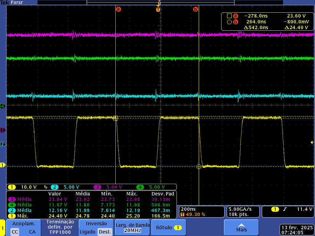

    2. Attached are the waveforms:
    Signal Color
    Vin Purple
    Vout Green
    Sw2 Blue
    Sw1 Yellow
    a) No-load condition (0A):
    b) 3A load condition:
    c) 3.8A load condition (Current limiting):
    Paulo

    When you test the waveforms with 3.8A load, did you see any oscillation when the time scale is zoomed out?

    4) When you test the waveforms with a 3.8A load, did you see any oscillation when the time scale is zoomed out?
    R.: No, the switching remains continuous.

  • Hi Paulo,
     I think layout is not good compared to our guideline. 5556.TPS55288 Layout Guideline (Rev B).pdf
    If you still have chance to modify the design, recommend to follow layout guideline.
    Since the ISN and ISP voltage limit 50mV, it makes sense that ISN-ISP is already 47.55mV when Iout is limited to 3.8A. We need to figure out why the current sence circuit has such large error.
    1. You didn't add RC filter in the output current sense trace. Add a 0.1uF cap in parallel with the sense resistor.
    2.Move the EVM current sense resistor to your PCB to see if the sense resistor error is too large.
    3.
    What issues could arise if I do not use a shunt resistor and rely only on the ILIM resistor for current limitation?
    There is no issue if you don't use the shunt resistor. You can choose to remove the resistor.
    But the layout is not good for me, especially power loop. There will be some spike issue. Recommend to modify the design.
    Mulin

    However, I realized that I am using the shunt resistor incorrectly in my design. The shunt resistor I chose for the project is a four-terminal type (L4T20FR010FER), and I mistakenly connected the V and I terminals together on the PCB. The correct approach is to use the I (Current) terminals for current flow and the V (Voltage) terminals for measuring the voltage drop across the resistor. I will modify the PCB and manufacture a new board for testing. Unfortunately, it is not possible to rework the current board.
    But the layout is not good for me, especially the power loop. There will be some spike issues. I recommend modifying the design.
    R.: Would it be possible to highlight the critical points in the layout I sent? That way, I can try to correct all the layout errors in this new design.
