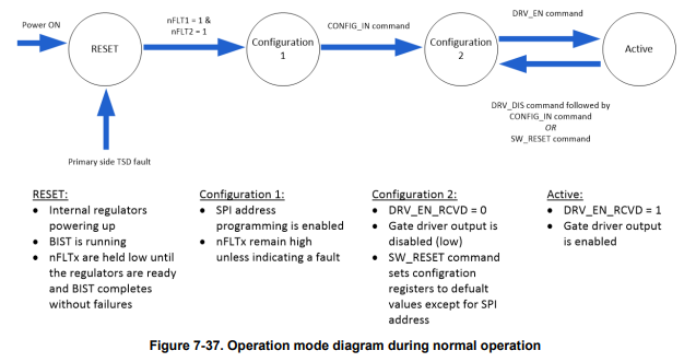

    For clarification, is the nFLT1 pin low after the device is powered up or is it low after a SPI command?
    Your code does not look like it is following the flow diagram to put UCC5870 into the proper operation mode to configure the device. It looks like you are trying to write to CFG1 (0x00) to configure the UVLO1 without entering the Configuration 2 mode.
  • in order to write first we have to go to config 2 and then use wr_RA command then use WRH or WRL depending on which bit we need to program right?

    but its not giving me data on the sdo line after i am done writing in the register. although now no FLT pin is triggered, so i am hoping writing is happening. Can you check, this is the updated code:

    You should not normally see faults when performing SPI

    Based off of the waveform, you are likely getting the fault because of a mismatch in your SPI commands. The device will trigger an SPI communication fault is when nCS transitions low and high without receiving a proper amount of SCLK pulses (multiple of 16).
    I am letting a member of the C2000 team know the issue and they will be able to further assist you in correcting your SPI code.
