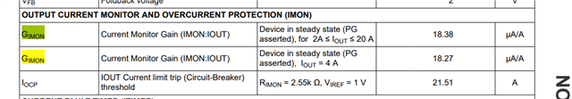

In the datasheet there's this spec:

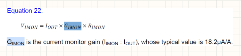

And in Eq 22:
Shouldn't that be 18.38 uA/A ?  It does make a difference.

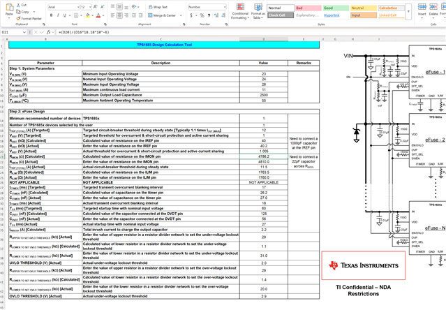

Also in the I(ocp) calculation above with R(imon) = 2.55K - the value for G(imon) calculates to ~ 18.23 uA/A - but if this is for rated load - should 18.38 uA/A be used?  That results in R(imon) being 2.529k - that's a difference (say PG asserted and load current ~ 10A).
