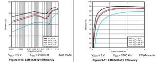

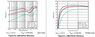

  • Hi Kura,
    Sincere apologies for the delay.
    Schematic review - Overall the schematic looks okay - I do not see any issues with the design.
    Coming to the observations -
    If the customer needs fixed frequency operation - they have to shift to LM61430AFS-Q1 - the only major drawback is the efficiency at light loads - it will be much worse compared to auto mode.
    If you see the comparison in the above screenshots (taken from the datasheet) - AUTO mode maintains efficiency above 80% across different operating voltages and output currents - while FPWM efficiency is much worse when the output load is in the mA range.
    Regarding the waveform - frequency foldback is expected which can be seen in the capture that you have shared. However, for the sleep mode - I would expect a severely reduced frequency. Is the customer checking this after the soft start is over and the output voltage has stabilized at 5V and 3.3V?
    Taru
