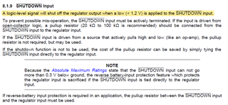

Hello Forum,
I need the high-level input threshold (VIH) for ~SHUTDOWN pin of IC LP2952.
I could not find it in the datasheet of LP5952/3.
PS - Although, they've mentioned the VIL level indirectly in section 8.1.9, there is no visible reference to the VIH level. (Refer below attached image)
Please revert back if you have any useful information on this.
