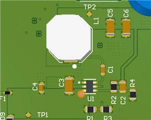

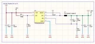

  • Dear Eric,
    thank you for your swift reply.
    Attached at the end you will find the schematic and the layout.
    Vin is 24V, Vout is 3.3V, Iout is slightly above 200mA.
    The saturation current of the coil is 4A, the RMS current is 3.3A.
    It seems like the IC always breaks internally between SW and GND, resulting in a resistive path of ~5Ohms between those two pins. My assumption is that this means that the low-side FET broke, and the 5Ohms might be due to the internal current sense resistor/circuit?
    I had two hypothesizes:
    • ESD issue; however we already broke several ICs, and with ESD I never had an issue in such a continuous/repeatedly way (unless using an ESD gun).
    • In some cases we used a programmer attached to the 3.3V line, which also sourced the voltage, so when we turn off the main power, the device gets reversed sourced (open input and 3.3V external voltage source at the output). However when I use a test setup to intentionally force this condition, the IC is supper resistant, and I’m not able to destroy it using this approach.
    Any hint is very much appreciated.
    Daniel

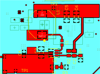

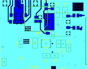

    Layout:
     3D:
    The GND net is highlighted in light blue on every layer.
    Top-Layer:
    Top 1 (Inner layer):
    Bot 1 (Inner layer):
    Bot-Layer:
  • Hi Daniel,
    I think this may be the root cause of the broken issue. The schematic and layout seems OK.
    Please make sure the external power supply tied to 3.3V output is always turned off and see if this broken issue happens again.
    Eric
