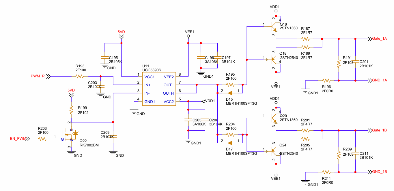

I have designed an FET drive circuit using the UCC5390S, but I am currently experiencing significant FET ringing and am seeking a solution.
  1. I am considering removing the push-pull circuit. Could you kindly confirm whether the UCC5390S is capable of driving two FETs? The datasheet indicates a sink current of 10A.
  2. I believe that using the UCC5350M Miller Clamp IC could help mitigate this issue. However, would I need to use one IC per FET?
  3. If you have any additional recommendations for resolving this issue, I would greatly appreciate your advice.
Thank you in advance for your support.

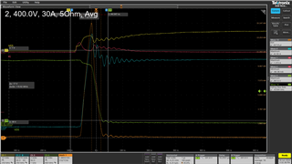

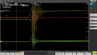

    Here is a comparison of turn-on resonance in the same exact circuit with a Si FET (STW78N65M5) vs. a SiC FET (C3M0015065D) with 5Ohms gate resistance and the UCC5350:
    Silicon FET:
    Silicon Carbide FET:

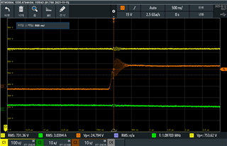

  • Thank you for your response.
    The waveform below shows the FET gate-to-source (G-S) signal (C3).
    I am currently using an SiC FET, specifically the IMZA65R015M2H (Infineon).
    Additionally, if I remove the push-pull circuit from the schematic, would it be possible to use the UCC5350M instead?
    I would appreciate your advice on this.
  • Hi Tae,
    If this is already a SiC FET, the next step I recommend is to revisit your a high-voltage decoupling network to dampen the supply ringing. The supply is shorted to the switch node when it is ringing.
    You can certainly pin-to-pin swap the UCC5390 and the UCC5350. However, UCC5390 is a stronger device.
