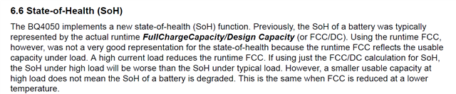

The customer feedback that the SOH will vary with the temperature.
Whether it is normal?
What is the definition of FCC_SOH? It is the same with BQ40z50?

The biggest variables used in SOH is measuring coulomb counting during discharge and/or impedance of the cell. Temperature and especially low temperature is able to make the internal resistance much higher compared to if it was in ambient temperature. Although short experiences with low/high temperature shouldn't effect much of the SOH capacity prolonged exposure would. In BQStudio temperature is taken into factor in creating the ChemID to optimized for accuracy between 0°C and 50°C.
The definition of "FullChargeCapacity/State of Health" would be the same for both gauges however the BQ40z50 uses impedance tracking to get the FFC_SOH and BQ4050 uses CEDV to get FFC_SOH. Below I attached the documentation between the difference in the algorithm to reach the target value but typically impedance tracking does a more accurate job of determining FFC_SOH of a cell.
