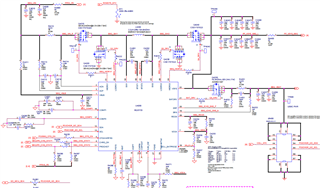

attach the SCH for reference, appreciated!

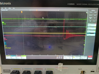

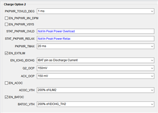

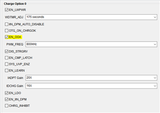

    I think the charger is already enabled. please see the captured waveform, disconnected pack from system, apply 15V on charger's VBUS, no system load, charger is enabled and work in PFM mode, and the BATDRV(CH4)=VSYS_MIN(CH2), BATFET is turned off, and VBAT=0V.

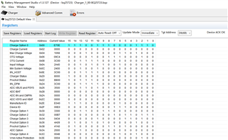

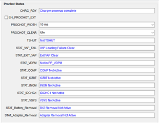

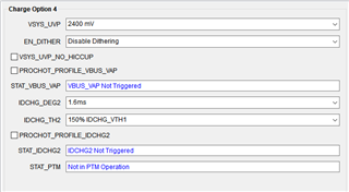

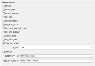

    To clarify more clearly, also using EV2400 and battery management studio GUI to capture the register status as below, no abnormal found.
  • I know, the charger is live.
    To enable charge, set charge current() register(0x02) >0 and CHARGE_INHIBIT=0.
    Tiger
