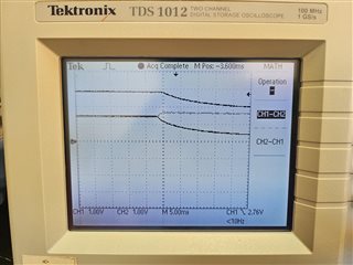

No I said it will blink for a very short moment when removing VCPU as VLED stay On a little longer. The other user seems to have the same issue on Drive 1, for me it's hard to know what drive as all 4 are connected...
Hi Francois,
Do you have any waveform to describe this phenomenon? Actually, this is the first time to meet such problem. It will be better if there is a waveform.

Sure I will ask my technicien to record one. Only does that with red leds as the V forward is lower.

Here is the traces when removing VCC and V Led is dropping slower (More caps on it.)
A Red Led will flash for a moment.
Top trace is VLed
Bottom is the other side of the led (chip side)
Gray trace is the Math difference between the two. Difference get between 1.6V to 1.9V, the red led start at 1.6V of V Forward.
