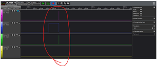

    2. If you probe the SPI lines (J2) and power the board, do you see SPI traffic that would indicate the PD controller is booting?
    I checked the SPI signal. It is as shown in the figure below. It seems to be abnormal. Is that correct?
    The red circle is enlarged. There is no change in CSZ signal.

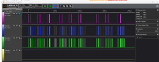

    3. If you can connect up to the I2C2 lines (J2), can you try sweeping the I2C addresses on that pin? You should see something ack at 0x20 and 0x21
    The data is not visible as shown in the picture below.

  • Hi Shin,
    I'll need a couple days to check the SPI lines on an EVM on my side. It does seem unusual the CS does not change level.
    If the IC is not acking on any I2C addresses while being powered properly, then the IC could be dead. It does look like the I2C lines are toggling so nothing on the lines seem to be forcing it high or low. I'm not too sure what you are showing in the second picture, I'm assuming you are using some I2C host to read from one of the addresses mentioned? Could you zoom in?
    Abnormal would be if the device does not ack at all on any I2C address when powered. I2C2 should always be an I2Ct line.

  • Hi Chistopher
    I enlarged it but there was no change. That's why I didn't attach the enlarged photo.
