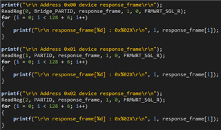

I want to check the CMU's partid (0x500) is 0x00 (BQ79718-Q1) using this code.
But I get the 0x80 results for CMU... and I think the transceiver partid reading is done well.
From the under image, the response_frame[4] should get the partid..
But you can see, the 0x80 is the value.
Why can't I get the Part ID from the CMU?
please let me know.
  • Hi JJ,
    Are you able to view the communication through a logic analyzer? You are correct that the 4th indexed byte should be the data. My concern though is that I'm expecting another byte of data in the response frame.
    Your response frame is as follows:
    - numbre of bytes where 0x00 refers to 1 byte
    - device address where you have 0x01 and 0x02 referring to the addresses of your bq79718
    - the next two bytes are register addresses so you have 0x500 being reported
    - the next byte is what is reported in the requested device address
    - there are two bytes where you only show 1 that represents a CRC value.
    I'd like to check the CRC value to make sure that the response frame you are seeing is correct.

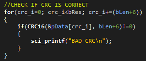

    I just use the EVMs and COMH -> COML -> COMH ... sequences. I hard to upload the picture in here. sorry.
    I changed the code like this. also, I turned on the CRC error print code in the ReadReg() function
    Quick question 1. In this code, Which is readtype parameter recommended? FRMWRT_SGL_R or FRMWRT_STK_R?

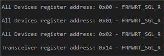

    And, this is the results from the entire response_frame for the 3 devices(transceiver, 2 CMU's)
    There is no "BAD CRC" console contents,, what happened to me?

    My code is here to read 8 bytes starting from DIE_ID1
    And the result is here.
    Please let me know about the result.
