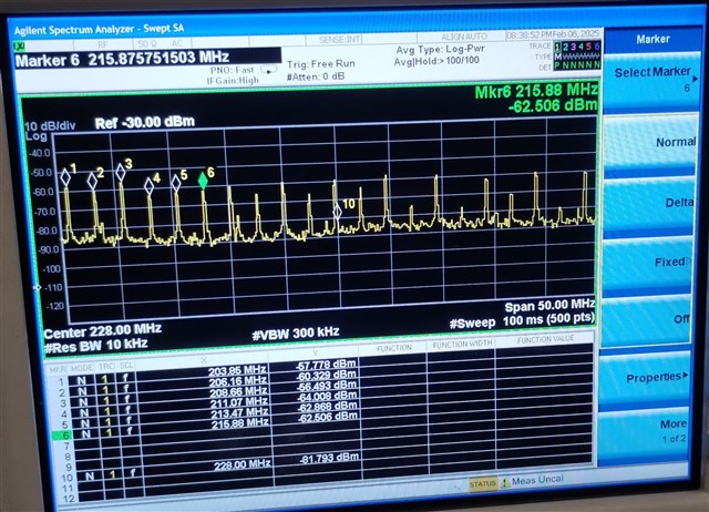

Hi
I am using TPS62420DRC ,and now am getting a sprctrum as shown in below and spacing between each peak is near to 2.25 MHz which is the switching frequency of TPS62420DRC.
I am failing RE at 190 and 228 Mhz. How to resolve this?
