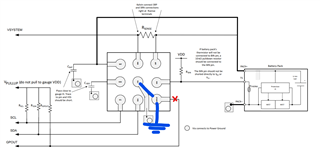

We would like to use the BQ27426YZFR battery fuel gauge in our product, but the very small DSBGA package complicates matters: in order to route the VSS pin, we would need to select a more expensive PCB manufacturer capable of achieving smaller trace widths and tighter tollerances, or capable of doing via-in-pad. Our product needs to be very competitive, so we can't afford an increase in PCB cost.
The BQ27427 fuel gauge (with integrated Rsense) would technically solve our issue, since the central VSS pad can be connected to the other VSS pin nearby. This eliminates the issue of routing a small trace between two outer pads. Unfortunately, our product can draw spikes of up to 5A for short periods (at least 500ms), which is above the maximum ratings of the integrated sense resistor.
My idea is to use the BQ27426YZFR and route VSS over the GPOUT pin, as shown in this picture:
We will not be putting the fuel gauge in SHUTDOWN mode (I don't see a usecase, our product has a power switch), so I don't need GPOUT to exit SHUTDOWN. We also don't need the BAT_LOW signal that GPOUT can provide (as we can just read the state of charge from I²C). Finally, GPOUT is an open-drain output, so there is no risk of short circuit.
The datasheet, however, recommends to add a pull-up resistor if GPOUT is not used:
Can I safely get away with connecting GPOUT to VSS and routing over it? I don't want to end up with a malfunctioning fuel gauge that enters a weird state because it senses low on that pin.
Kind regards,
Marco Cipriani

  • Hello, I fixed the pictures, please let me know for the GPOUT pin, I need this information to continue PCB design
  • Hello Marco,
    This is an acceptable way to route the GPOUT pin.
    Thank you,
    Alan

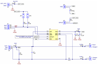

  • Hello Marco,
        Although the system may work route it in the way you have it above, it is heavily not recommend since the chip heavily depends on direct connection to ground. I would follow the image below for schematic phase.
        Also after reviewing the pervious schematic again, it seems that routing VSS over GPOUT should work in the system, but you are running a high risk and lower reward outcome where you could get intermediate wakeup signals to the chip. Most PCB fabs should be able to handle the tolerance needed to run a trace in-between the pins or putting a via under on the pad or next to the pad to get VSS to GND.

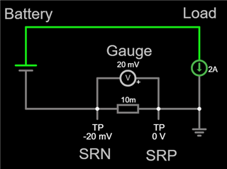

    Where to connect the VSS pin is something I'm a bit concerned about. I did see the "Typical Application" schematic you sent me, but I thought something was off: if VSS is connected to system/load ground, then the gauge is going to see a negative voltage on its SRN pin because the gauge reference is at a higher potential (2A of current through a 10mΩ resistor = 20mV, not much, but also not zero). If the analog circuitry inside the fuel gauge can accurately measure the current even with SRN below zero, then there is no problem. Not every differential amplifier can measure with one or both inputs below ground.

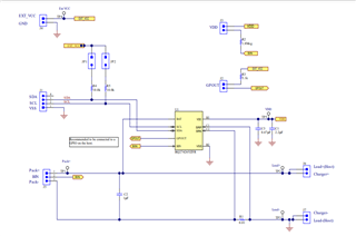

    In conclusion, if you can confirm that the fuel gauge will work with SRN below ground, I will modify my schematic like so:

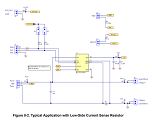

    The R sense resistor is used to gauge the flow of current within a system through having a know resistance and being able to determine voltage coming in and out of the resistor. SDA and SCL shouldn't pull below ground since all the ground from the cell and chip are the same it reference that as zero meaning it can't go below the system ground. The way you currently have your schematics setup is correct based on the low side schematic below in page 16.
    pg 16
    https://www.ti.com/lit/ds/symlink/bq27426.pdf?ts=1740515090222&ref_url=https%253A%252F%252Fwww.ti.com%252Fproduct%252FBQ27426
