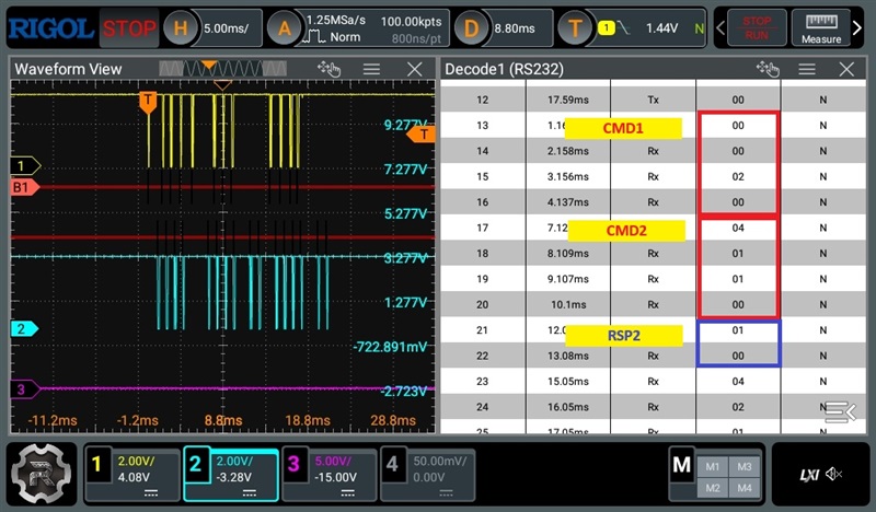

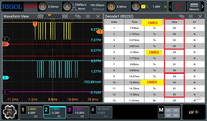

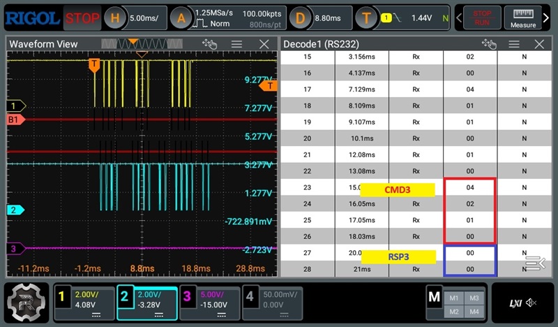

    I've captured a command exchange between the SFRA application and the board:
    MCU->GUI
    GUI->MCU
    According to the source code, the command exchange looks like this:
    1. CMD_00: PULSE, Payload 2, LED toggle
    2. CMD_04; GET_VAR, read var group 1, sfra_status. Value 1.
    3. CMD_04; GET_VAR, read var group 2, sfra_frequency_index. Value 0.
    This command sequence is repeated throughout the communication without updating the frequency index.
  • I was able to capture the entire command exchange from the start of the sweep and the moment the application got stuck. These are the commands:

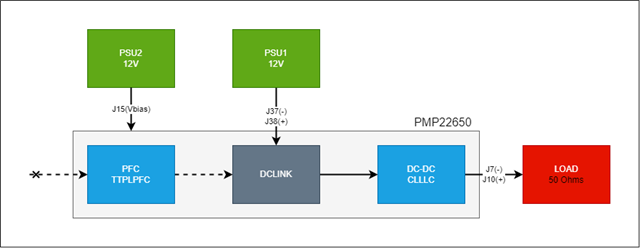

  • Hi Srikanth,
    Thanks for your reply.
    To give you some context of the test, this is the test diagram.
    1. We built the same board as the reference design (PMP22650). It should deliver 7.4kW.
    2. At the moment we don't have the disipators mounted on the board, so we're testing with very low values. At the moment we're connecting 12V (limited to 2A) in the DCLink power rail and a load of 50 OHms.
    3. This is the output of the SFRA:
