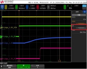

Hi Team,
May you help verify the startup time of TPS746-Q1? The result shows 1.17ms which is higher than datasheet shows. Our Cout is also 1uF.
Roy
  • Hi Roy,
    Can you provide a schematic? If the customer is using the adjustable version of the device and has a large feedforward capacitor, I would expect to see a longer startup time than the datasheet specifies.
    Alex Davis
