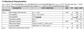

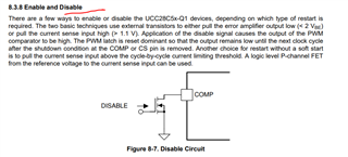

Hi Ti Team,
I am using  UCC28C55-Q1 in my DC-DC converter.
I am using VREF 5V to supply protection circuit of my internal circuit.
If i pull-down COMP pin with MOSFET during some fault condition.Still i need VREF-5V should be ACTIVE .Is is ACTIVE ??
or After i pull-down COMP pin ,  VREF-output will be zero?? can you please check and cofirm this...
