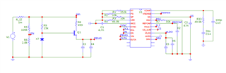

I'm having trouble simulating the TPS7H500x family in SPICE.  Using the unencrypted model for the TPS7H5006, I ran into an issue with the SS pin not supplying current to charge the SS capacitor.  I tried the unencrypted TPS7H5002 model and hit an error that appeared to be left over test code (line 712, starting with EDUMMY) and commented that line out.  Then I ran into the same issue as the TPS7H5006 model.
Nodes EN_LOGIC and N16635995 are going high, which appears to indicate all the start up conditions are met.  X_U3 appears to turn on the soft start charging current (source G_G1), but at the same time, X_S2 appears to short it to ground.
Am I missing something here?  Has anyone had success with these models

    Forcing the COMP pin should have no effect on the clock, which would point towards issues with the simulator.
    While I dont know your full schematic I am also suspicious of some of the values you posted in your picture.
    We can try simulating your schematic in our PSPICE for TI simulator so that we can try and separate what might be multiple issues.
    How much of your schematic are you able to share?

    Forcing the comp pin is the only way I get any switching in MicroCap.  Prior to the new line of code there was erratic behavior from the clock, but now there isn't.  I probably didn't pay much attention to the clock (SYNC pin) when there was no switching output, so the erratic behavior was probably there whether I drove the COMP pin or not.
    There's not much more than what I showed in the earlier screen grab.  We're still in a very preliminary design phase.  I threw my thumb in the wind for a lot of this.  I just want to get a good grasp on the part's behavior, like how soft start works.  The design of the power supply itself is the easy part.

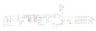

    Using your design values, I'm not seeing any instances where the duty cycle is getting stuck at 0 or 50% pulses or where the soft start cap isn't being charged. I tested using a simple switch+diode instead of primary FET and also provided VIN with a voltage source instead of the circuitry you're using - this was mainly to reduce the possible issues those components themselves could be introducing to the simulation for now.
    My guess is that MicroCap can't recognize parameters and needs the soft start current and threshold passed in as hard-coded values (SS_thresh=1 & I_ss=2.7u, as well as EA_gm=1800u). You could try searching for those parameters in the netlist file and replacing them with the hard-coded values and see if that resolves the charging issue in MicroCap, but if not I'm uncertain what the issue with that simulator would be.
    I also forgot to mention another step needed for the netlist alteration if using the 5006 model. You could use the 5001 model and connect the unused pins to a 1k resistor to GND as well, which may be a less error-prone method.
    1. Add this line to the netlist as stated originally: X_U117 SYS_CLOCK N16649359 BUF_DELAY_BASIC_GEN PARAMS: VDD=1 VSS=0 VTHRESH=0.5 DELAY=20n
    2. Alter this line: X_U42 BLANK NOT_BLANK SYS_CLOCKN16649359 DIG_HI N16649275 DIG_HI DFFSBRB_RHPBASIC_GEN_BLANK PARAMS: VDD=1 VSS=0 VTHRESH=0.5
    Sorry for the long post, but please let us know if this corrects the main issues you're seeing. I will also say increasing your SS time a bit and tuning the compensation will likely improve the resulting startup.
