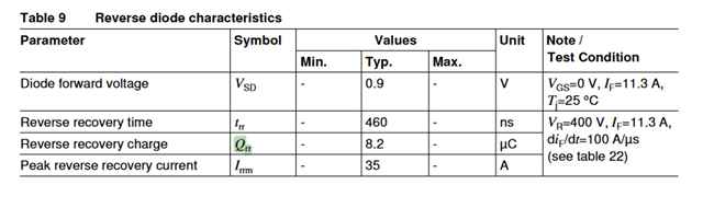

In LM5190 body diode power loss is mentioned as below.,
Vsupply = 36V
Fsw = 400KHz
Qrr = 8.2uC
MOSFET = IPB60R160C6
Prr = 118.08W which is not allowable ., Kindly suggest on the same
