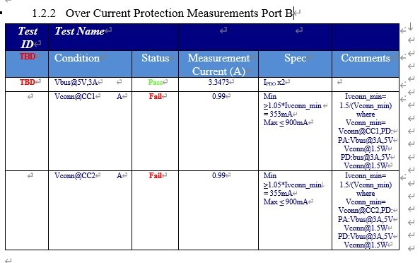

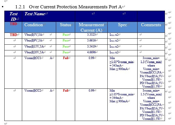

Hi TI support,
Product based on Gorilla Creek TI88
In LAB test report CC OCP issues.
Please help to check how to fix this?

Hi Clarence,
I am talking to the team regarding this as I have not seen this failure before but I will check with the team as I believe there might be a way to change the VCONN setting in the GUI.

Hi Clarence,
I am ooo this week but I will have another engineer take a look in the meantime.
Do you know what equipment the lab used during this test? Would be helpful to see if we can recreate it with the gorilla creek reference board.

Hi Clarence,
This seems to be a marginal failure and I think we might be able to get a waiver here.
I will send an email to the intel lab folks to see if this is a possibility.
Thank you,
Kevin
