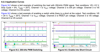

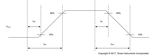

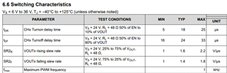

The specs for the maximum PWM frequency at 1kHz:
The waveform below shows a 5% duty cycle, 250 Hz signal, so the pulse width is 200µs.
Are we able to output a 200µs low + 200µs high square wave (equivalent to 50% duty cycle at 2.5kHz)? What is the highest frequency at 50% duty cycle that the chip can go?
